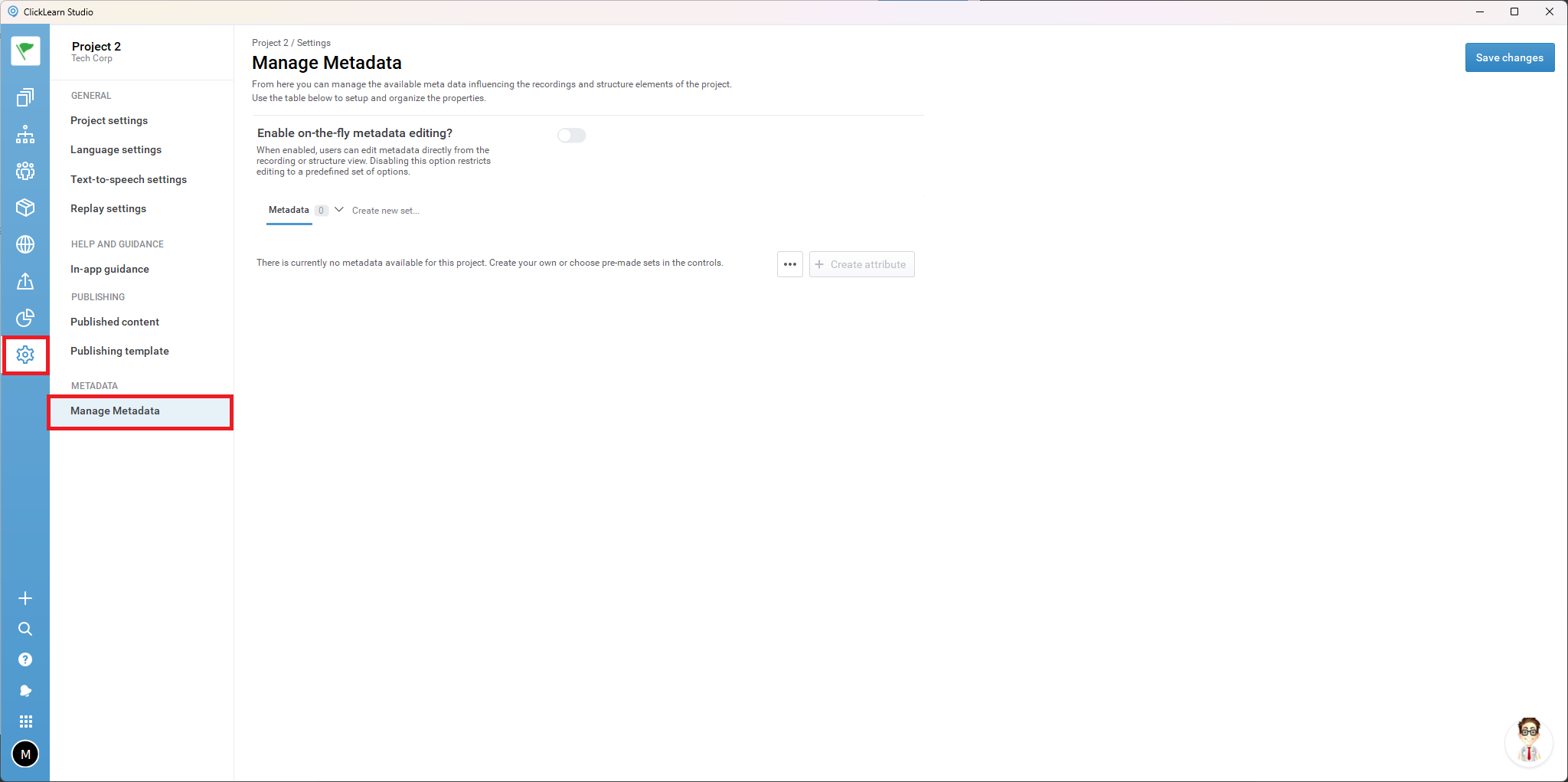

First, we want to access the properties. ClickLearn has a number of these pre-constructed properties to make the task easier. Click on Settings, then Properties.

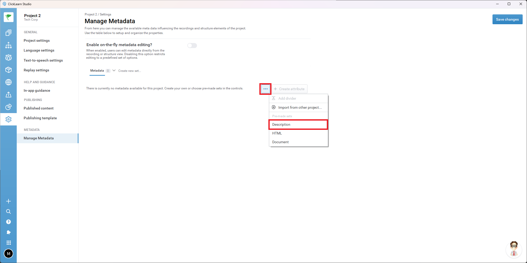

Tick Description and then click the Get started button.
Once the pre-constructed options appear, click Save changes.

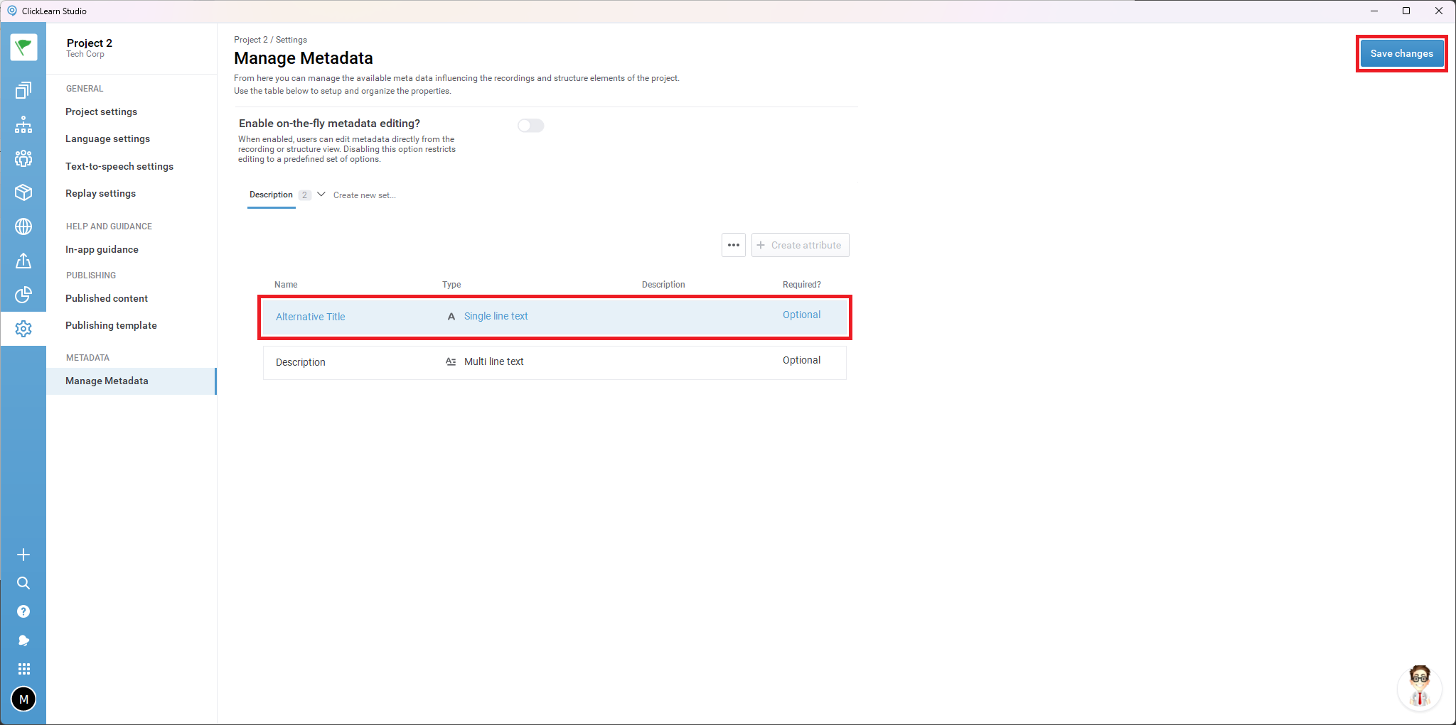

Select a recording. The area on the right will change and you can now select properties. Click Description.
Next, enter your desired Alternative Title. Remember, it can be as long as 72 characters. You can also enter a description. Click save after each change.
Click Save in the main Structure area.
The window will now refresh to display the new titles. This completes the process.
